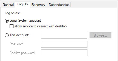

When a scheduled backup runs, the scheduler service (Desktop Services or Server Services) uses the default Windows account, Local System.
The Local System account will have access to all local and unmodified resources. However, it will not have sufficient permissions to access NAS and other UNC devices unless Active Directory enables them.
Change the user account running under the service (Desktop Services or Server Services) to the same as the logged-in Windows user that can run a manual backup or another account that has sufficient permissions to access the device on the UNC path.
