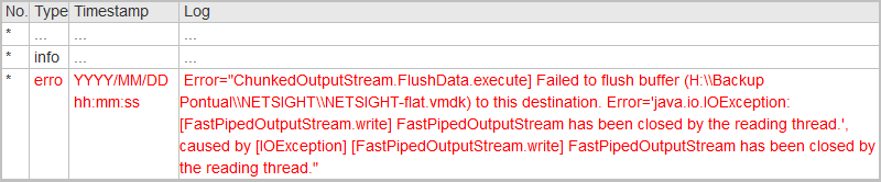

[ChunkedOutputStream.FlushData.execute Failed to flush buffer to this destination Error=com.ahsay.afc.cloud.d Failed to get OutputStream of file" (5231)
When running a backup job on AhsayOBM/AhsayACB the following error is shown in the backup log:
This issue is caused by an unstable network connection between the device backing up and the backup destination, or limited bandwidth.
