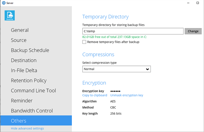

  3. Add a USB disk to your system for the temporary location during backups. If your backups are using a local drive for this location, that will increase IO on the system disks during the backup and can cause a VSS snapshot timeout error.
USB disks are incredibly cheap and perfect for the temporary cache or dump location. While at it, why not add another USB disk to use a local backup destination? It is free to do and will allow you to restore at LAN speeds if performing a basic (non-DR) data recovery.
If you change the temporary directory location for any other reason, you must edit that location in the backup set config below.
